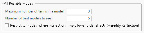

8. Enter 3 for the maximum number of terms, and enter 5 for the number of best models.
Figure 5.23 All Possible Models Pop-up Dialog
9. Click OK.
