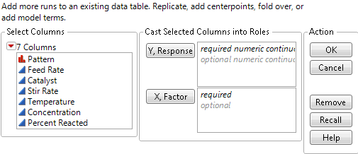

Launch the Augment Design platform by selecting DOE > Augment Design from the data table that contains the design that you want to augment.
Figure 6.9 Augment Design Launch Window
Y, Response
Enter the numeric response column or columns. Entering a response is required.
X, Factor
Enter the factor columns. Factors can be of any data type or modeling type.
