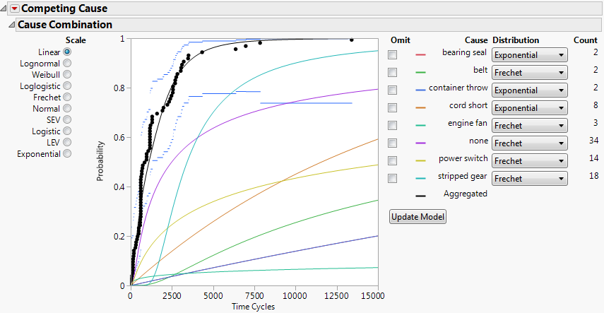

On the Competing Cause report, JMP shows the best distribution fit for each failure cause.
Figure 3.11 Initial Competing Cause Report
