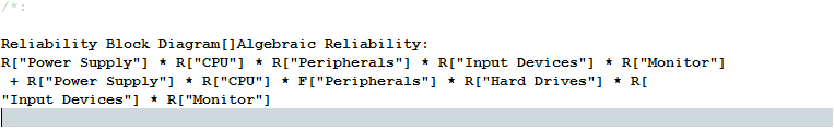

4. Click the Computer red triangle and select Print Algebraic Reliability to the Log Window.
The Log window displays the formula for the Algebraic Reliability of the selected block diagram.
Figure 11.29 Algebraic Reliability in Log Window
Note: Reliability formulas use “R” to represent a component’s reliability and “F” to represent probability of a component’s failure.
