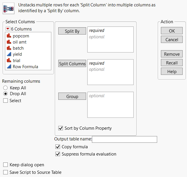

1. Select Tables > Split.
Figure 6.12 Split Window
2. Highlight the names of the column or columns that you want to split and click Split Columns.
3. Highlight a column whose values you want to use as the basis for splitting the column.
4. Click Split.
5. Customize your splitting further using the additional options.
6. Click Split.
Split Options
Select Columns Filter Menu
Contains options to search and filter through columns. See Column Filter Menu in the Get Started section.
Keep All
Includes all columns in the new table.
Drop All
Includes only columns used in the split in the new table. Selected by default.
Select
Selects which columns to keep in the new table.
Keep dialog open
Keeps the Split window open after you click OK.
Save Script to Source Table
Saves a script to the original data table that enables you to split the data again using the same settings.
Split By
Adds the column whose values you want to use as the new column names, and as the basis for splitting the column.
Split Columns
Adds the column or columns that you want to split.
Group
Specifies a Group variable when you want your data to be split within each group of the selected variable. Each group results in a row in the output table. You must also specify the required variables, Split By, and Split Columns.
Note: If the variable that you want to group by contains unequal groups or is in a random order, specifying it as the Group variable ensures that your data is restructured properly, and any missing values are assigned in the appropriate places.
Sort by Column Property
Sorts the order of the output columns by the Value Order column property. If the column doesn’t have a Value Order property, and the data has an implied order (such as days or months), the implied order is applied.
Output table name
(Optional) Specifies the name of the new table.
Copy formula
(Appears if there is a formula in the data table.) Includes formulas from the original table in the output columns.
Suppress formula evaluation
(Appears if there is a formula in the data table.) Prevents JMP from evaluating columns’ formulas when the new table is created.
