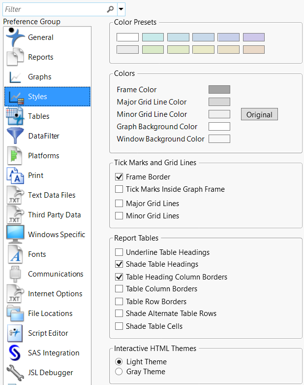

The Styles page enables you to customize colors, tick marks, grid lines, and report tables.
See Graphs for more information about configuring the appearance of graphs.
Figure 13.4 Styles Preferences
Table 13.4 Preferences on the Styles Page
Preference
Description
Color Presets
The Color Presets provides a set of predefined colors for use in customizing the appearance of reports, graphs, charts, and so on Tints of the selected color are applied to the various elements.
Note: The selected color is applied also to windows.
Frame Color
Defines the color applied to a graph frame and tick marks. Click to change the default color.
Major Grid Line Color
Defines the major grid line color. Click to change the default color.
Minor Grid Line Color
Defines the minor grid line color. Click to change the default color.
Graph Background Color
Click the color box to select a background color for all graphs. Click to change the default color.
Window Background Color
Click the color box to select a background color for all reports and data tables. Click to change the default color.
Original
Click to restore default color settings.
Frame Border
Shows borders only on the axes.
Tick Marks Inside Graph Frame
Shows axis tick marks inside the graph frame.
Major Grid Lines
Shows major grid lines on graphs.
Minor Grid Lines
Shows minor grid lines on graphs.
Underline Table Headings
Shows border under table headings.
Shade Table Headings
Shows table headings with shading.
Table Heading Column Borders
Shows divider lines between columns in table headings.
Table Column Borders
Shows borders between table columns.
Table Row Borders
Shows borders between table rows.
Shade Alternate Table Rows
Shows alternate table rows with shading.
Shade Table Cells
Shows table cells with shading.
Interactive HTML Themes
Specifies the color theme for interactive HTML pages.
