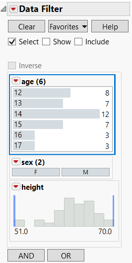

Once you have added columns in the initial window, the Data Filter control panel appears.
Figure 9.8 Data Filter Control Panel
The main controls in the Data Filter include the following:
Clear
Clears all selections that you have made on variables in the Data Filter window.
Favorites
Saves your current data filter criteria as a favorite. Once you have created a favorite, selecting it resets the current conditions to the criteria in the favorite. You can also remove the favorite. To retain favorites once the current session ends, save the data filter script by selecting one of the Save Script options from the Data Filter red triangle menu.
Select, Show, and Include
See Filtering Modes.
Inverse
Inverts the current selection state of the rows in the data table.
Note: Only the rows in the data table are inverted, not the selection in the Data Filter. To invert the selection in the Data Filter, from the column’s red triangle menu, select Invert Selection.
AND
The AND button opens the Add to Selected Group list. The and operator restricts the selection. You can add variables to the filter process at any time.
OR
The OR button opens the Add new OR Group list. The or operator extends the selection. You can add variables to the filter process at any time.

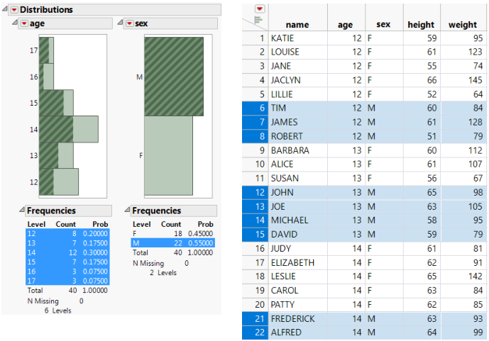

Figure 9.9 Rows Containing Males Highlighted in Data Table and Histograms
You can see that all of the rows containing males are highlighted in the data table and in the histograms. Now you decide that you want to see only the students who are age 12.

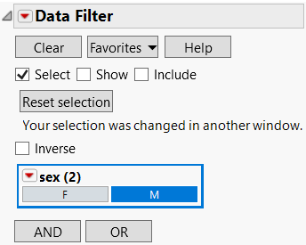

8. In the age histogram, select the bar representing age 12.
Now the selection does not match the Data Filter selection. A warning message and a Reset selection button appear in the Data Filter window.
Figure 9.10 Data Filter Warning Message and Reset Button
