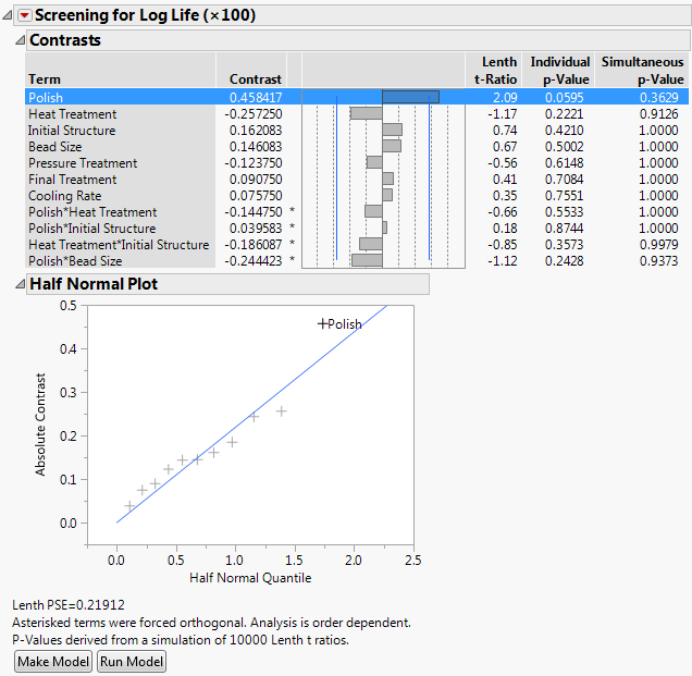

Figure 10.6 Screening Report for Weld-Repaired Castings.jmp
The only significant effect identified is Polish. Note that asterisks mark four terms, indicating that they are not orthogonal to the effects preceding them. The contrast values obtained for these effects are after orthogonalization. As a result, these estimates do not match estimates obtained from a corresponding regression analysis. You can use the Run Model button to fit the single-factor model.
