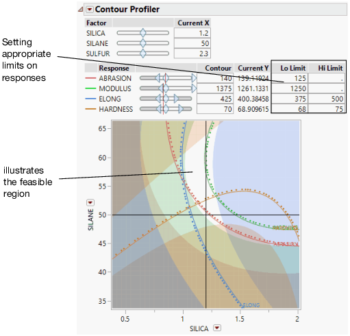

Profilers > Contour Profiler > Constraint Shading Settings
If you specify limits for the response columns, the areas of the plot that are outside of the feasible region are shaded. The unshaded white area represents the feasible region.
Figure 4.5 Settings for Contour Shading
