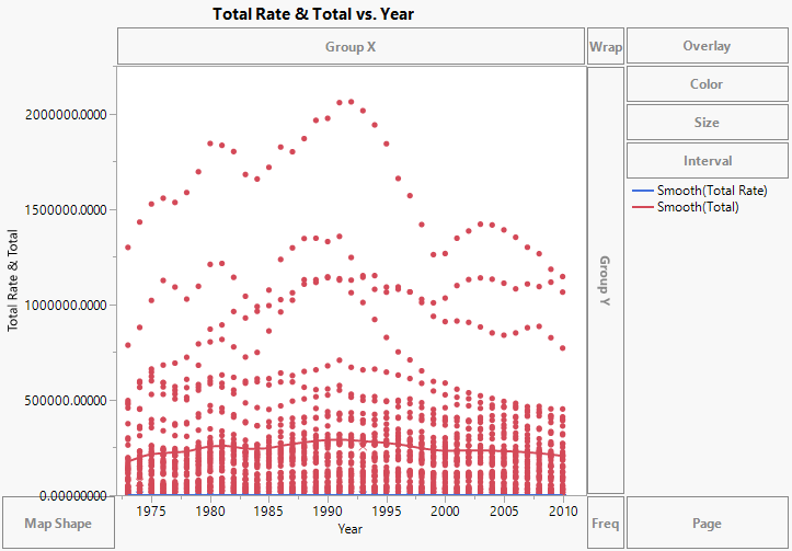

3. Select Total Rate and Total and drag them to the Y zone.
4. Select Year and drag it to the X zone.
Figure 3.14 Total Rate and Total Merged
The Total Rate values are all between 0 and 1, and they are barely visible. Calculate yearly means and then use a second Y axis to make these values visible.

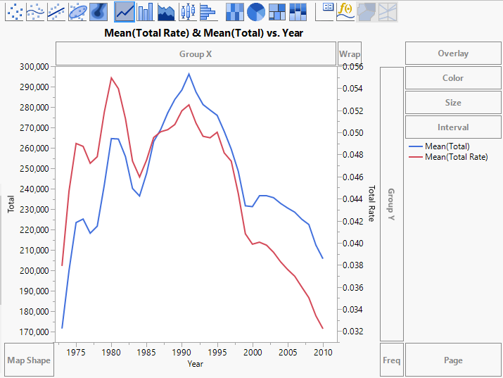

5. In the options panel for Points, select Mean next to Summary Statistic.
6. Click the Line element .
7. Right-click the variable names in the Y zone and select Move Right > Total Rate.
Figure 3.15 Second Y Axis Added
An axis for Total Rate is added on the right, and the axes rescale to show both sets of values. You can now see relationships between the two measures. For example, both measures began to decrease in 1991.
