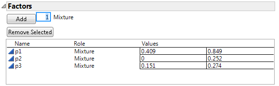

3. Click the Mixture Design red triangle and select Load Factors.
Figure 13.20 Factors and Factor Constraints for the Plasticizer Experiment

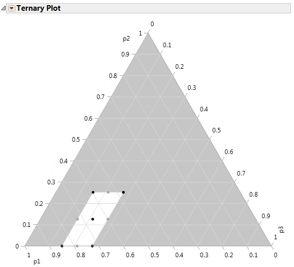

8. To identify the vertex points and the centroid use a ternary plot. From the design table, select Graph >Ternary Plot.
9. Select p1, p2, and p3 and click X, Plotting, and then click OK.
Figure 13.22 Ternary Plot for Design
10. Highlight the vertices and centroid points.
Figure 13.23 Identify Vertices and Center Point
