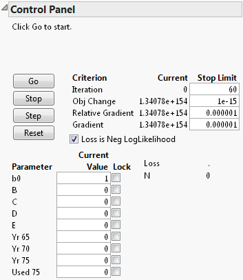

6. Set the Current Value (initial value) for b0 to 1, and the other parameters to 0.
Figure 14.15 Enter New Parameters

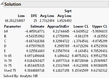

8. Click the Confidence Limits button.
The Solution report appears. The results include the parameter estimates and confidence intervals, and other summary statistics.
Figure 14.16 Solution Table for the Poisson Loss Example
