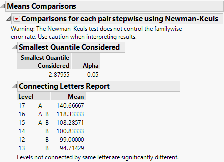

6. Click the red triangle next to Oneway Analysis of weight By age and select Compare Means > Each Pair Stepwise, Newman-Keuls.
Figure 6.22 Example of Means Comparisons Report for Each Pair Stepwise, Newman-Keuls
The Connecting Letters Report shows that Level 17 is significantly different from all other levels except 16 and 15.
