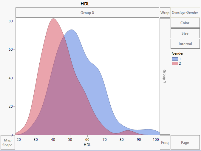

3. Select HDL and drag it to the X zone.
4. Select Gender and drag it to the Overlay zone.
5. Click the Histogram element icon .
6. In the Histogram properties panel, from the Histogram Style list, select Kernel Density.
Figure 4.24 Overlaid HDL Histograms by Gender
The histograms indicate that HDL levels are higher in males (blue) than females (pink). The blue distribution falls to the right, or higher on the HDL scale, than the pink distribution. Now change the graph to view the differences in gender in a ridgeline plot.

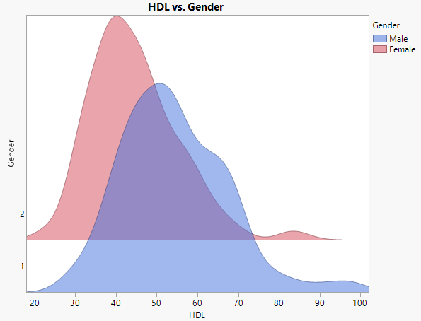

7. Select Gender and drag it to the Y zone.
8. In the Histogram properties panel, move the Overlap slider to overlap the histograms (until the slider is about 3/4 up).
9. Click Done.
10. Double-click in the legend. In the Legend Settings window, double-click 1 and type male. Double-click 2 and type female.
11. Click OK.
Tip: If an item in the legend is still highlighted, click it to deselect it.
Figure 4.25 Ridgeline Chart of HDL by Gender and Diabetes Level
The ridgeline chart shows the gender distributions offsets.
