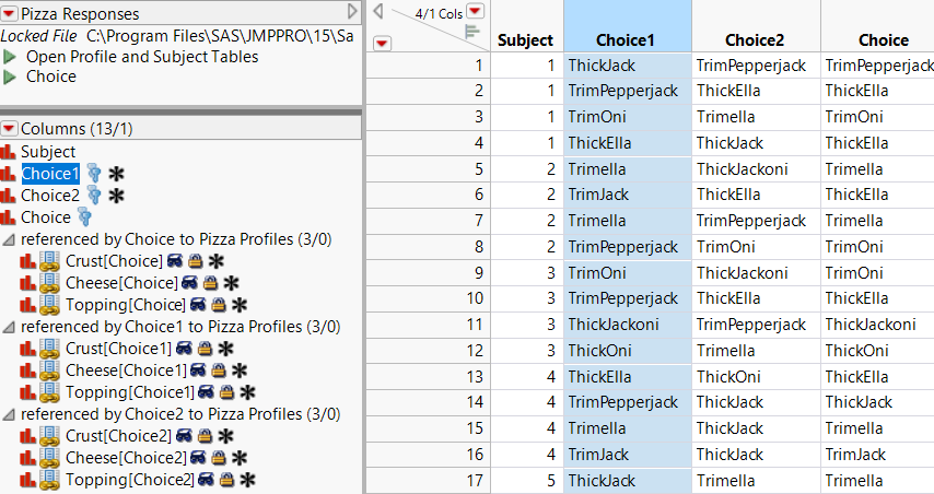

2. Right-click the ID column in Pizza Profiles.jmp and select Link ID.
3. Select the Choice1, Choice2, and Choice2 columns in Pizza Responses.jmp and then select Link Reference > Pizza Profiles.jmp.
The selected columns are linked to the ID column in Pizza Profiles.jmp.
Figure 6.40 Selected Column in Virtually Joined Data Table

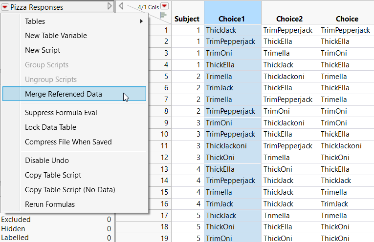

5. Click the red triangle next to the name of the data table and select Merge Referenced Data.
Figure 6.41 Merging Referenced Data

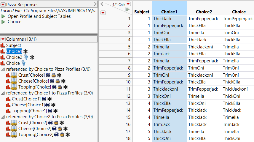

A message confirms that the selected column was merged. Notice that the blue virtual join icon for Choice1 no longer appears in the Column list. The Link Reference column property was removed.
Figure 6.42 Merged Data
