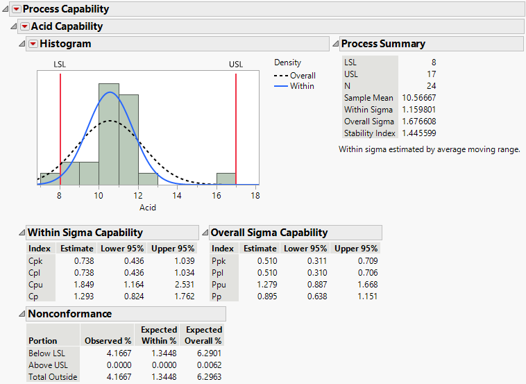

Suppose you want to characterize the acidity of pickles. The lower and upper specification limits are 8 and 17, respectively.

Figure 3.21 Example of the Process Capability ReportĀ
The Process Capability results are added to the report. The specification limits appear on the histogram in the Process Capability report so that the data can be visually compared to the limits. As you can see, some of the acidity levels are below the lower specification limit, and some are very close to the upper specification limit. The Ppk value is 0.510, indicating a process that is not capable, relative to the given specification limits.
