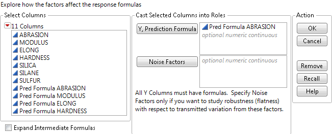

3. Select Pred Formula Abrasion and click Y, Prediction Formula.
Figure 3.2 Completed Prediction Profiler Launch Window
4. Click OK.

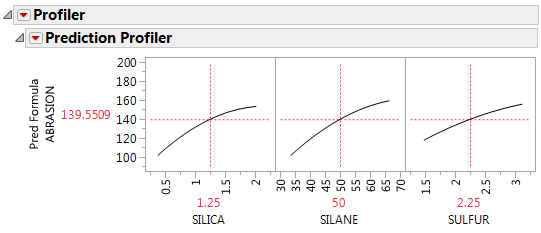

Figure 3.3 Prediction Profiler Report Window
The profiler is interactive. The vertical red lines correspond to the current value of the factors. The current value of each factor is also shown in red below the horizontal axis. The red value on the vertical axis is the predicted response based on the current values of the factors. Click and drag the vertical red lines to change the current values of the factors. Click a factor’s red value to set the factor to a specific value.

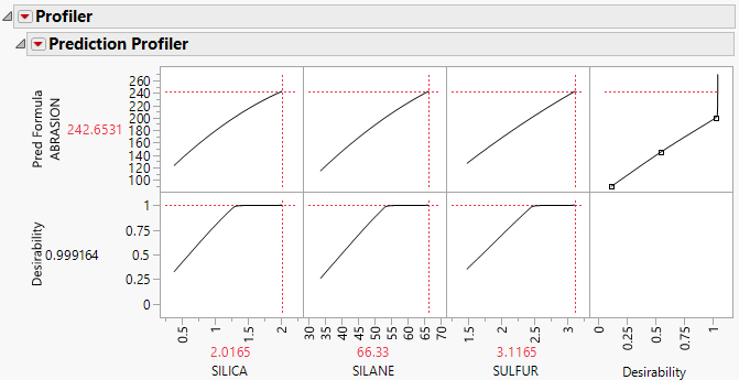

5. Click the Prediction Profiler red triangle and select Optimize and Desirability > Desirability Functions.
6. Click the Prediction Profiler red triangle and select Optimize and Desirability > Maximize Desirability.
Tip: You might need to adjust the vertical axis of the prediction profiler to view the maximum value of ABRASION in the plot.
Figure 3.4 Maximize Desirability Report
By maximizing the desirability, you see that to maximize ABRASION, all factors are set to their highest levels.
