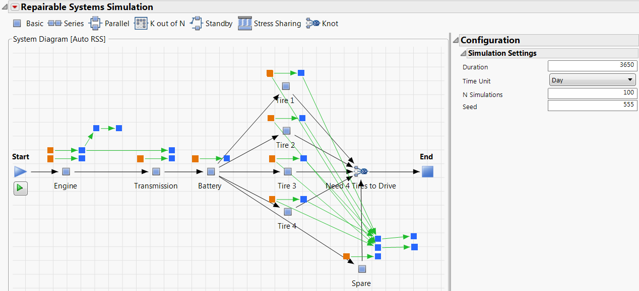

1. Select Help > Sample Data, click Open the Sample Scripts Directory, and open Car Repair Simulation.jsl.
Figure 12.2 Car Repair System Diagram
An RSS window that diagrams a car system appears. In the diagram, the first block on the left is the Start block. Notice in the Configuration panel, on the right side of the RSS window, that the simulation is set to run for 3650 days.
2. (Optional) Enter 555 next to Seed.
Because the simulation involves random component failures, this action ensures that you obtain the exact results shown below.
3. Click the green triangle below the Start block to simulate the car system.

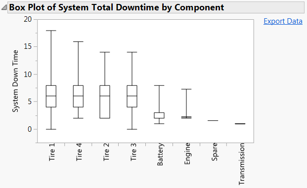

5. Click the red triangle next to Repairable Systems Simulation Results - Number and select Box Plot of Total System Downtime by Component.
Figure 12.4 Partial Box Plot of Total System Downtime by Component Report
You conclude that the tires cause the most downtime for the car system. To increase the average total system availability, you might consider using more durable tires or carrying another spare tire.
