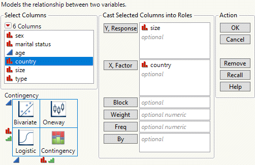

To perform a contingency analysis, do the following:
1. Select Analyze > Fit Y by X.
2. Enter a nominal or ordinal column for Y, Response.
3. Enter a nominal or ordinal column for X, Factor.
Figure 7.3 The Fit Y by X Launch Window
The word Contingency appears above the diagram, to indicate that you are performing a contingency analysis.
Note: You can also launch a contingency analysis from the JMP Starter window. Select View > JMP Starter > Basic > Contingency.
For more information about this launch window, see Introduction to Fit Y by X. For more information about the options in the Select Columns red triangle menu, see Column Filter Menu in Using JMP.
