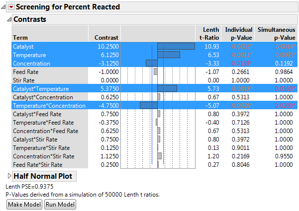

Figure 10.10 Fit Two Level with N = 50,000 Simulations for p-Value Derivations
The number of simulations is stated in the report window.
