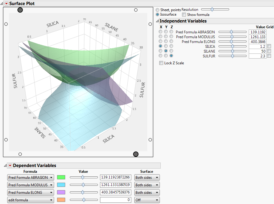

5. Select the Isosurface radio button in the appearance controls.
6. In the Dependent Variables report, select Both Sides from the Surface menu for all three variables.
Figure 5.14 Isosurface of Three Variables
For the tire tread data, one might set the abrasion at a fixed minimum setting and the elongation at a fixed maximum setting. Use the MODULUS slider to see which values of MODULUS are inside the limits set by the other two surfaces.
