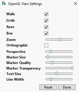

Settings
Opens a window for changing many plot settings. For more information about the OpenGL Scene commands, see Three-Dimensional Scenes in the Scripting Guide.
Figure 5.11 OpenGL View SettingsĀ
