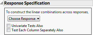

Response Specification
Specify the response designs for various tests using the Response Specification panel.
Figure 9.3 Response Specification PanelĀ
Choose Response
Provides choices for the M matrix. See Choose Response Options.
Univariate Tests Also
Obtains adjusted and unadjusted univariate repeated measures tests and multivariate tests. Use in repeated measures models.
Test Each Column Separately Also
Obtains univariate ANOVA tests and multivariate tests on each response.
