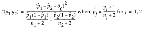

where the adjusted Wald statistic is defined as follows:
