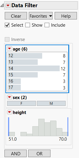

Once you have added columns in the initial window, the Data Filter control panel appears.
Figure 9.8 Data Filter Control Panel
The main controls in the Data Filter include the following:

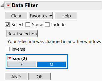

Changing the Row State in the Data Table After Making Data Filter Selections
If you have made selections in the Data Filter and subsequently alter row states in the data table, or select points in a graph or plot, the selections in the Data Filter might not match the selections in the data table. The Data Filter contains a warning message that says: “Your selection was changed in another window”. The Reset Selection button appears. Clicking the Reset Selection button changes the data table selections back to reflect the selections in the Data Filter.

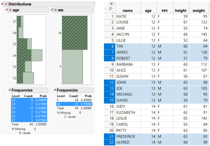

7. In the Data Filter control panel, select all of the males by clicking on the M block.
Figure 9.9 Rows Containing Males Highlighted in Data Table and Histograms
You can see that all of the rows containing males are highlighted in the data table and in the histograms. Now you decide that you want to see only the students who are age 12.
8. In the age histogram, select the bar representing age 12.
Now the selection does not match the Data Filter selection. A warning message and a Reset selection button appear in the Data Filter window.
Figure 9.10 Data Filter Warning Message and Reset Button
