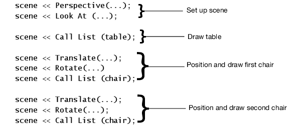

Translate and Rotate are also used to position objects with respect to each other. The first Translate or Rotate can be thought of as positioning everything that follows with respect to the camera. Subsequent Translate and Rotate commands are used to position objects, such as spheres, cylinders, disks, and display lists in Call List and ArcBall commands. For example, suppose you have a display list named table and another named chair. Your scene might look like this:
Figure 13.7 Using Translate and Rotate

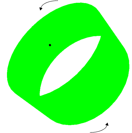

The following example uses the Rotate command inside a For loop to continuously change the viewing angle of a scene. It draws a cylinder that swings around a central point. This central point is shown by a small sphere.
scene = Scene Box( 600, 600 ); // make a scene box...holds an OpenGL scene.
New Window( "Example 1", scene ); // put the scene in a window
For( i = 1, i < 360, i++,
	scene << Clear;
// the lens is 50 degrees, near is 1 units from the camera, far is 10.
	scene << Perspective( 50, 1, 10 );
	scene << Translate( 0.0, 0.0, -2 );
	scene << Rotate( i, 1, 0, 0 );
	scene << Rotate( i * 3, 0, 1, 0 );
	scene << Rotate( i * 3 / 2, 0, 0, 1 );
	scene << Color( 0, 1, 0 ); // green for cylinder
	scene << Cylinder( 0.5, 0.5, 0.5, 40, 10 );
	scene << Color( 0, 0, 0 ); // black for sphere
	scene << Sphere( 0.01, 10, 5 );
	scene << Update;
	Wait( 0.01 ); );
Figure 13.8 Rotating a Cylinder
Note the use of the Update command at the end of the scene messages. This command tells JMP to make the displayed screen agree with the current state of the display list. It is important to clear the list at the beginning (so that the list does not contain the old angles as well as the current) and update the scene after each change.
