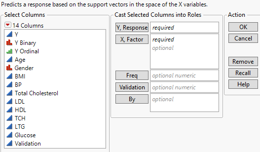

The Support Vector Machines Launch Window
Use the SVM launch window to specify your response and model factors. If used, validation and by columns are also specified in the launch windows.
Figure 9.4 Support Vector Machines Launch Window
The Support Vector Machines launch window provides the following options:
Y, Response
The categorical response variable that you want to analyze. This variable can be a binary or multi-class categorical variable.
X, Factor
The predictor variables.
Freq
Validation
A numeric column that contains at most three distinct values. See Validation in the Partition Models section.
By
A column or columns whose levels define separate analyses. For each level of the specified column, the corresponding rows are analyzed using the other variables that you have specified. The results are presented in separate reports. If more than one By variable is assigned, a separate report is produced for each possible combination of the levels of the By variables.
