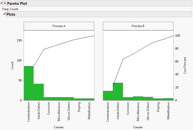

8. Click OK.
Figure 13.12 Pareto Plot Report Window

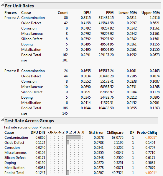

9. Click the Pareto Plot red triangle and select Count Analysis > Per Unit Rates and Count Analysis > Test Rates Across Groups.
Figure 13.13 Per Unit Rates and Test Rates across Groups Results
Note that the sample size of 101 is used to calculate the DPU for the causes in group A. However, the sample size of 145 is used to calculate the DPU for the causes in group B.
If there are two group variables (say, Day and Process), Per Unit Rates lists DPU or rates for every combination of Day and Process for each cause. However, Test Rate Across Groups only tests overall differences between groups.
