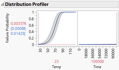

Figure 22.1 Profiler Showing Failure Probabilities for ALT Experiment
