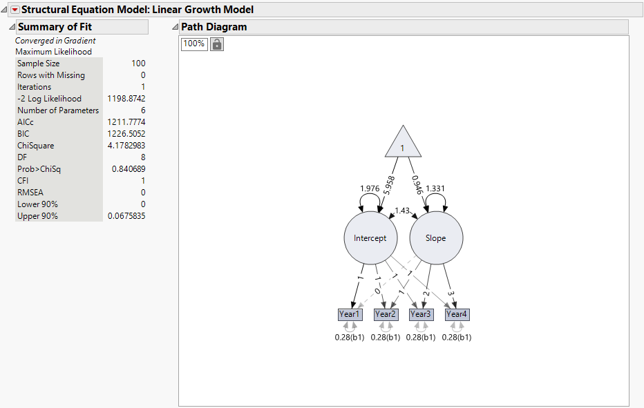

Figure 8.11 Summary of Fit and Path Diagram for Linear LGC Model
The chi-square statistic for this model, listed in the Summary of Fit report, is 4.18 with 8 degrees of freedom. Note that the corresponding p-value is 0.8407, which is not significant. This indicates that there is not evidence to reject the null hypothesis that the model fits well. Therefore, you conclude that this model fits the data reasonably well. The CFI and RMSEA fit indices also indicate excellent fit as they are greater than 0.9 and lower than 0.1, respectively.

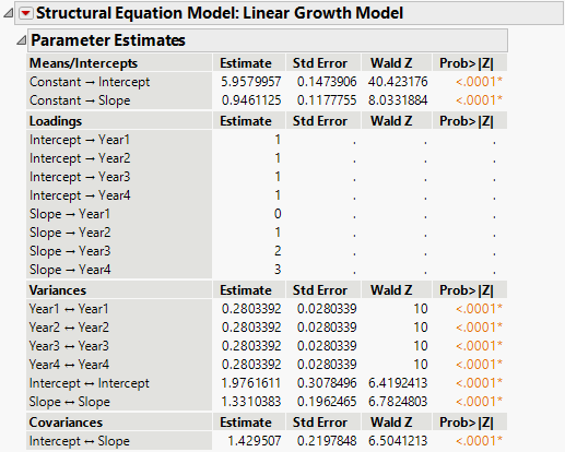

Figure 8.12 Parameter Estimates for Linear LGC Model
The mean estimate of the intercept is 5.96, which indicates the overall achievement score at year 1. This means that, on average, students’ academic achievement is 5.96 on the first occasion of measurement. The mean of the intercept is centered at the first occasion because the slope factor has a zero loading on that variable.
The mean estimate of the slope is 0.95, which indicates that the overall achievement scores increase by 0.95 each year. The significant variance estimates of the intercept and slope factors point to significant variability around the average trajectory; not everyone starts at the same place and not everyone increases at the same rate. External variables can be used as predictors of the intercept and slope to understand what leads to differences in the trajectories of individuals.
Lastly, the positive covariance between intercept and slope suggests that those who start with higher levels of academic achievement on the first year tend to increase more rapidly over time.
