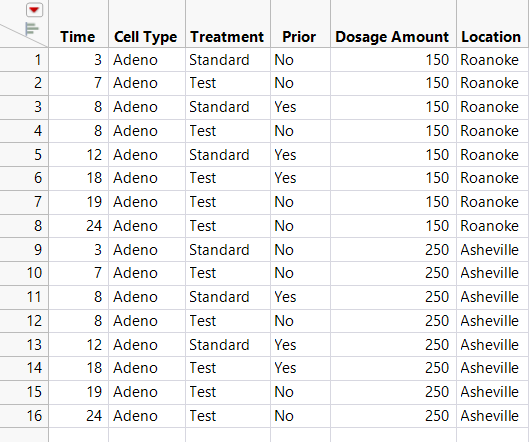

For example, suppose that two cancer trials were conducted at two different hospitals. One of the trials’ data is in the Cancer1.jmp data table, and the other trial’s data is in the Cancer2.jmp data table.
To consolidate the data and the variables into one table, follow these steps:
1. Select Help > Sample Data Library and open Cancer1.jmp and Cancer2.jmp.
Notice that there are two distinct table variables: Dosage Amount and Location. In the concatenated table, columns are created for these two table variables.
2. From the Cancer1.jmp data table, select Tables > Concatenate.
3. Select Cancer2 and click Add.
4. Click OK.
Figure 6.21 Data and Variables Concatenated
The data and the variables are concatenated. The variables appear as columns in the concatenated table. The notes from each data table are added to the new data table as table variables.
