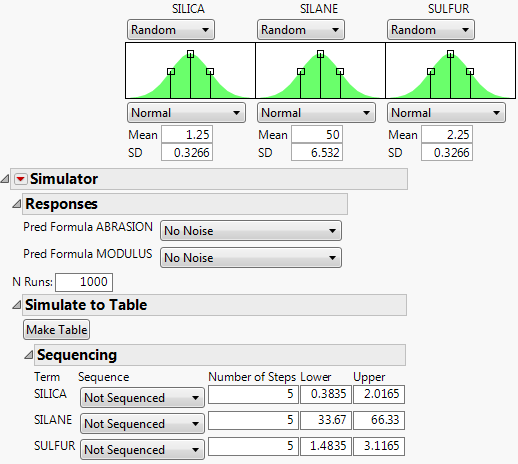

5. Click the Prediction Profiler red triangle and select Simulator.
6. Beneath each factor select Random.
Note: The default random distribution is a normal distribution.
7. Change the N Runs value to 1000.
8. Open Simulate to Table outline and then open the Sequencing outline.
Figure 8.2 Simulator SettingsĀ
Simulator Settings

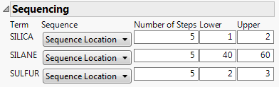

You want to examine how the responses change as the input factors change locations. To explore changes in factor mean, use sequence location. To instead explore changes in the variability of the factor, use sequence spread.
9. For SILICA, select Sequence Location. Leave the number of steps set to 5. Set the Lower limit to 1 and the Upper limit to 2.
10. For SILANE, select Sequence Location. Leave the number of steps set to 5. Set the Lower limit to 40 and the Upper limit to 60.
11. For SULFUR, select Sequence Location. Leave the number of steps set to 5. Set the values Lower limit to 2 and the Upper limit to 3.
Figure 8.3 Sequencing SettingsĀ
Sequencing Settings

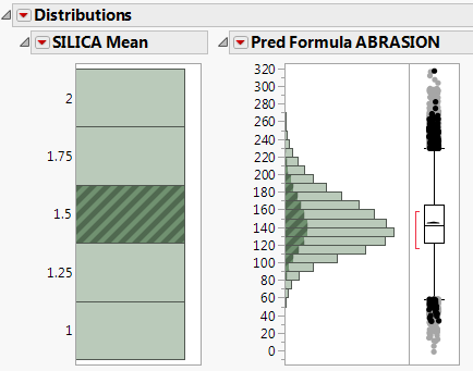

13. Select Analyze > Distribution.
14. Select SILICA Mean and Pred Formula ABRASION and click Y, Columns.
15. Click OK.
Figure 8.4 Distribution of SILICA Mean by Pred Formula ABRASIONĀ
Click a histogram bar that corresponds to a SILICA Mean to see how the predicted value for abrasion varies across the simulated silane and sulfur ranges given the selected value of silica.
