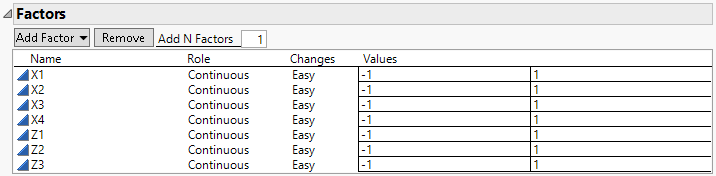

In this example, you are interested in finding optimal settings for four control settings in the presence of three noise factors.
1. Select DOE > Custom Design.
2. In the Factors outline, type 4 next to Add N Factors.
3. Click Add Factor > Continuous.
4. In the Factors outline, type 3 next to Add N Factors.
5. Click Add Factor > Continuous.
6. Double-click X5 and change it to Z1 to designate a noise factor. Repeat to change X6 and X7 to Z2 and Z3.
Figure 5.83 Factor Outline for Design with 4 Control and 3 Noise Factors
7. Click Continue.

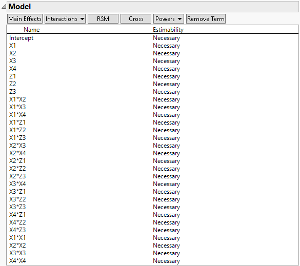

Next you set up the model that for exploring optimal settings for the control factors that are least impacted by the noise factors.
8. The model contains all main effects by default.
9. Click Interactions > 2nd to add all two-way interactions.
This enters the control by control interactions, the control by noise interactions, and the noise by noise interactions. You do not want to estimate the interaction between noise factors.
10. Scroll to the bottom of the list, highlight Z1*Z2, Z1*Z3, and Z2*Z3 and click Remove Term.This removes the noise by noise interactions.
11. In the Factors outline, select X1, X2, X3, and X4.
12. In the Model outline, click Powers > 2nd to add the control variable quadratic terms.
Figure 5.84 Model Outline for Design with Noise Factors
13. Add two center points by entering 2 In the Number of Center Points: text box
14. Click Make Design.
