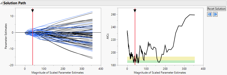

9. Select Smallest in Green Zone as the Initial Displayed Solution.
10. Click Go.
Figure 7.9 Smallest in Green Zone Model
The Solution Path shows the smallest model that is considered comparable to the minimum AICc model, where smallest model means the one with the fewest parameters.

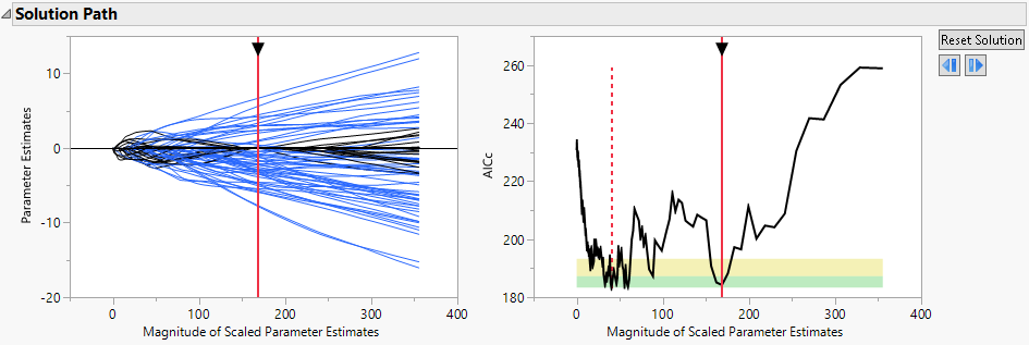

13. Select Best Fit as the Initial Displayed Solution.
14. Click Go.
Figure 7.10 Best Fit Model
Best Fit Model
The Solution Path shows the best fit model, where best fit means the one with the minimum AICc value.

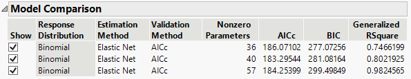

Figure 7.12 Model Comparison Table
The Model Comparison report shows the three models. You can identify the size of each model using the Nonzero Parameters column. As the number of parameters in the models increases, the Generalized RSquare values increase. Because these models are all in the green zone, there is strong evidence that any of these models are comparable to the best model.
