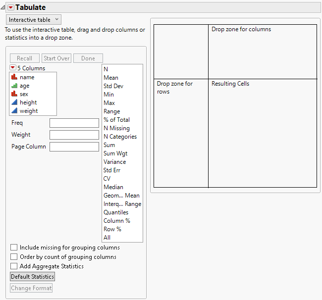

To launch the Tabulate platform, select Analyze > Tabulate.
Figure 9.7 The Tabulate Interactive TableĀ
Note: For more information about red triangle options, see Tabulate Platform Options. For more information about the options in the Select Columns red triangle menu, see Column Filter Menu in Using JMP.
The Tabulate window contains the following options:
Interactive table/Dialog
Switch between the two modes. Use the interactive table mode to drag and drop items, creating a custom table. Use the dialog mode to create a simple table using a fixed format. See Use the Dialog.
Statistics options
Lists standard statistics. Drag any statistic from the list to the table to incorporate it. See Add Statistics.
Drop zone for columns
Drag and drop columns or statistics here to create columns.
Note: If the data table contains columns with names equal to those in the Statistics options, be sure to drag and drop the column name from the column list. Otherwise, JMP might substitute the statistic of the same name in the table.
Drop zone for rows
Drag and drop columns or statistics here to create rows.
Tip: You can also select one or more columns in the columns list, select one or more of the statistics, and then Alt-click (Option-click on macOS) on a drop zone to create rows or columns in the table.
Resulting cells
Shows the resulting cells based on the columns or statistics that you drag and drop.
