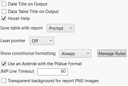

Figure 13.3 Reports Preferences
Reports Preferences
Table 13.3 Preferences on the Reports Page
Preference
Description
Date Title on Output
Select this option to display the date and time the analysis occurred in your report windows. This option is deselected by default.
Data Table Title on Output
Select this option to display the name of the data table and notes, if there are any, at the top of the report. This option is deselected by default.
Hover Help
On some numeric output, JMP provides tooltip-style help when you circle the mouse over a result.
Select this option to see a tooltip where it is available. This option is selected by default.
Note: If you deselect this option, hover label graphs no longer appear.
Save table with report
Select one of the options from the menu to determine how a table is saved to a report:
Embed
When you save a report, the table is embedded into the report. Choose this option if you want to share the report with others. The data table that is stored in the report is reopened (unchanged) each time the report is opened. If you make changes to the table, they are not saved into the report unless you re-save the report.
Separate
When you save a report, the table is referenced in the report.
Prompt
When you save a report, you are prompted to specify how to save the report: either to embed the table within the report, or to add a reference to the table in the report. This is the default setting.
Laser pointer
JMP has a built-in laser pointer that enables you to visually emphasize parts of a report. The option is deselected by default. To turn it on, select a color for the laser pointer from the list.
Show conditional formatting
Conditionally formats the color of the text that represents the values. Available for correlation values, p-values, and factor pattern values.
Select one of the options from the menu:
Always
Conditional formatting is always applied to correlation values, p-values, and factor pattern values. This is the default setting.
Screen Only
Conditional formatting is always applied to correlation values, p-values, and factor pattern values. However, the conditional formatting does not show when the report is printed.
Never
Conditional formatting is never applied to correlation values, p-values, and factor pattern values.
Manage Rules
Creates custom conditional formatting rules that can be applied to numeric columns or matrices. See Use Conditional Formatting in Reports.
Note: Verify the Use an Asterisk with the PValue Format preference to ensure that the asterisk (*) is or is not used for any p-value conditions.
Select this option to display an asterisk (*) next to significant p-values. This option is selected by default.
Note: Verify any conditional formatting rules for PValue to ensure asterisk (*) is not used for any defined conditions.
JMP Live Timeout
Species the timeout value for publishing to JMP Live. The default time is 60 seconds.
Transparent background for report PNG images
Select this option to display a transparent background when a report is saved as a PNG file. This option is deselected by default.
