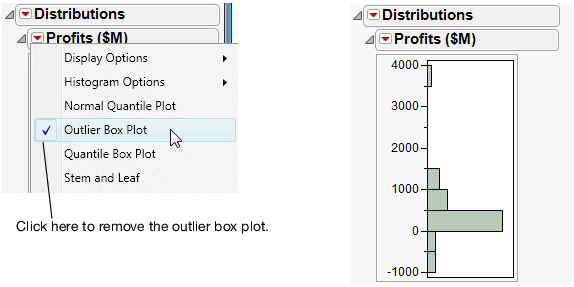

Continue using the Distribution report that you created earlier.
1. Click the red triangle next to Profits ($M) to see a menu of report options.
2. Deselect Outlier Box Plot to turn the option off.
The outlier box plot is removed from the report window.
Figure 2.7 Removing the Outlier Box PlotĀ
