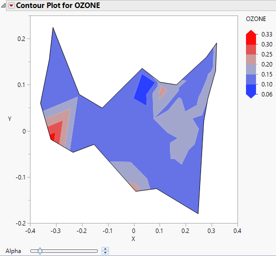

This example illustrates how to create a triangulation data table, to transform the triangulation to use Delaunay triangles, and to filter Alpha shapes of the triangles.

7. Click the red triangle next to Contour Plot for OZONE and select the following options:
a. Transform > Range Normalized
Instead of Delaunay triangulation, this changes the method for calculating the triangulations to a normalized scale ([0,1]) in both X and Y.
b. Show Control Panel
The Alpha slider appears.
Figure 10.11 Contour Plot for OZONEĀ
8. Click and move the Alpha slider to the right.
Figure 10.12 Alpha Shapes FilterĀ
Alpha Shapes Filter
Using the Alpha slider filters out the larger Delaunay triangulation areas.
