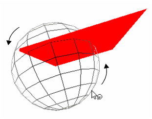

This displays the script with an associated arcball with diameter 2. When you run the script and the window appears, right-click and select Show ArcBall > Always from the menu that appears.

This sets the display so that the ArcBall is always showing. Click and drag on the ArcBall to rotate the scene. The right-click menu with Background Color, Use Hardware Acceleration, and Show ArcBall is always available, whether the scene is displayed through a platform, in a journal, or through JSL.
Note: The ArcBall does not have to be showing to react to mouse commands. It is shown here for display purposes only.

Figure 13.9 Showing the Arc Ball
