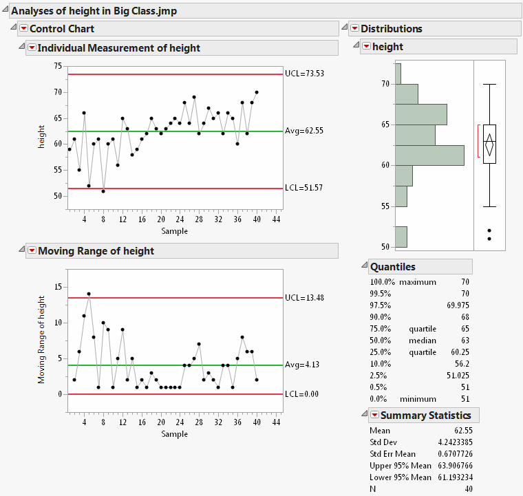

The following example creates several graphs and reports in one window:
csp = New Window( "Platform Example",
	Outline Box( "Analyses of height in Big Class.jmp",
		H List Box(
			cc = Control Chart(
				Chart Col( Height, "Individual
				Measurement", "Moving Range" ),
				K Sigma( 3 )
			dist = Distribution( Columns( Height ) )
Figure 11.25 Example: Multiple Graphs in One Report Window

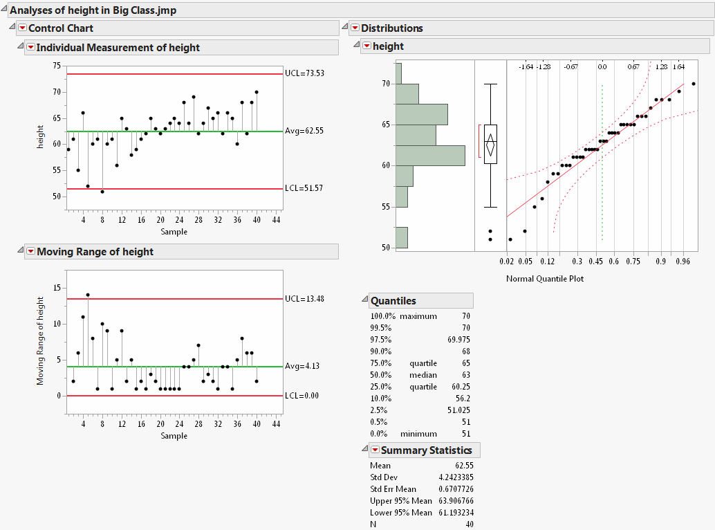

You can send messages directly to the platform references themselves. Find out your options by searching for “Distribution” and “Control Chart” in the JMP Scripting Index. For example, Control Chart provides a message called Needle that creates a needle chart. Distribution provides a message called Normal Quantile Plot.
To execute these options from JSL, send them as messages to the platform references:
cc << Needle;
dist << Normal Quantile Plot;
Figure 11.26 Changing a Custom Report
