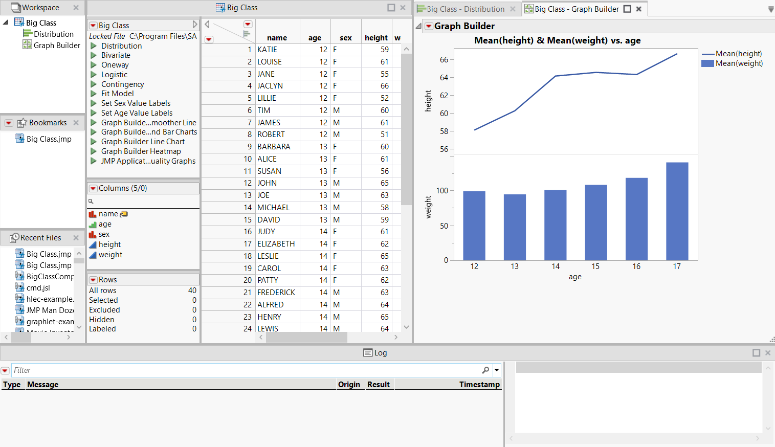

A more complicated JMP project might include a Bookmarks pane (to show file, folders, and groups that use frequently), and a project log. The data table and output are in separate tabs.
Begin by creating a new project and creating a bookmark.

Set Layout specifies the layout of the tabs that show the data table and output.

Figure 15.2 Example of a Complex Project
