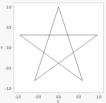

Line() draws lines between points on a JMP graph.
win = New Window( "Five-Point Star",
	Graph Box(
		Frame Size( 300, 300 ),
		X Scale( -1.1, 1.1 ),
		Y Scale( -1.1, 1.1 ),
		Line(
			{Cos( 1 * Pi() / 10 ), Sin( 1 * Pi() / 10 )},
			{Cos( 9 * Pi() / 10 ), Sin( 9 * Pi() / 10 )},
			{Cos( 17 * Pi() / 10 ), Sin( 17 * Pi() / 10 )},
			{Cos( 5 * Pi() / 10 ), Sin( 5 * Pi() / 10 )},
			{Cos( 13 * Pi() / 10 ), Sin( 13 * Pi() / 10 )},
Figure 12.10 Using Lines to Draw a StarĀ

The star example could also be drawn this way. Note that the script must include the full Matrix( {...} ) notation rather than [ ] shorthand because the entries are expressions. The following example uses the Matrix() function.
