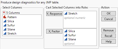

To launch the Evaluate Design platform, open the data table of interest and select DOE > Design Diagnostics > Evaluate Design.
Figure 16.10 Evaluate Design Launch Window
The launch window contains the following buttons:
Y, Response
Enter the response column or columns. Entering a response is optional. Response values are not used in evaluating the design. Responses must be numeric.
X, Factor
Enter the factor columns. Factors can be of any Data Type or Modeling Type.
