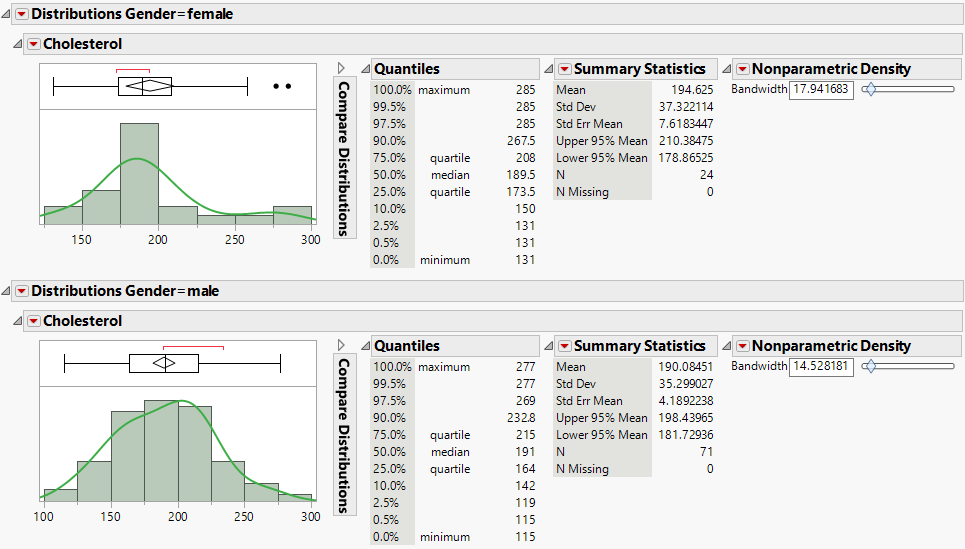

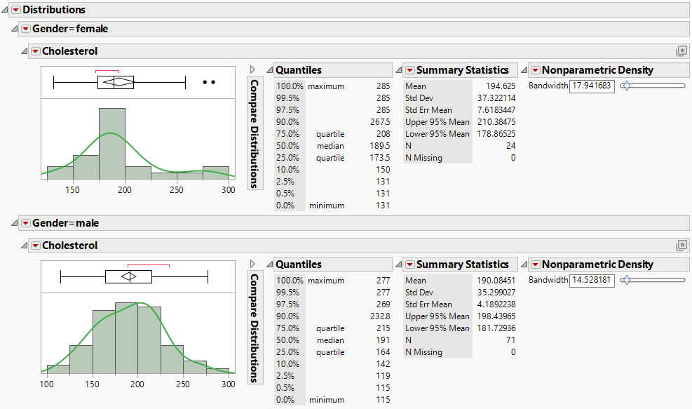

Change the orientation of the histograms and the reports.
6. Click the Distributions red triangle and select Stack.
Add a smooth curve to both histograms.
7. Hold down the Ctrl key. Click the Cholesterol red triangle and select Continuous Fit > Fit Smooth Curve.
Hide the Compare Distributions report.
8. Hold down the Ctrl key. Click the gray disclosure icon next to Compare Distributions.
Figure 3.14 Separate Distributions by GenderĀ
