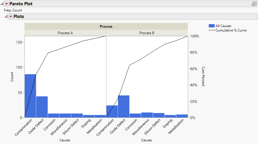

8. Click OK.
Figure 15.9 Pareto Plot Report Window
Process A indicates Contamination as the top failure while Process B indicates Oxide Defect as the leading failure.

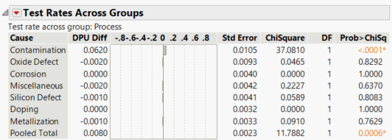

9. Click the Pareto Plot red triangle and select Test Rates Across Groups.
Figure 15.10 Test Rates across Groups Results
Note that the DPU for Contamination across groups (Process A and B) is around 0.06.
