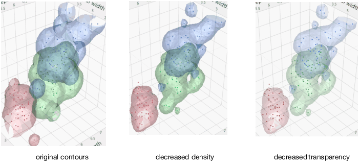

5. Click the Scatterplot 3D red triangle and select Nonpar Density Contour.
6. Select Grouped by Column.
7. Select Species and click OK. A different colored contour is displayed for each of the three species.
8. Type 0.25 in the first Contour Quantile box. 25% of the data points appear outside the contour surfaces, which results in smaller contours.
9. Type 0.15 in the first Transparency box. The contours are 15% opaque.
Figure 9.10 Changing the Nonparametric Density Contour Transparency and Density

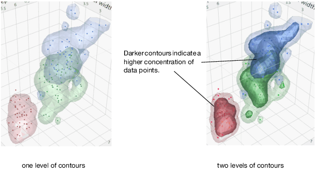

10. Select the second check box. The contour quantiles are the same (.25), so the new contours overlap the first ones.
11. Type 0.5 in the second Contour Quantile box. 50% of the data points appear outside the contour surfaces. A second set of contours appears within the first, to further illustrate the density of the data points.
Figure 9.11 Adding a Second Nonparametric Density Contour
