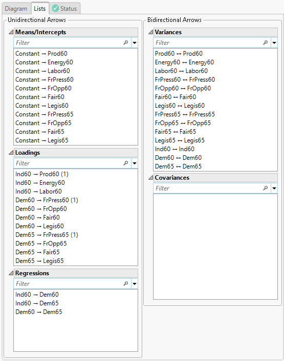

Add Loading and Regression Variables
9. Select Ind60 in the From List, select Dem60 in the To List, and click the unidirectional arrow Image shown here button.
10. Select Ind60 in the From List, select Dem65 in the To List, and click the unidirectional arrow Image shown here button.
11. Select Dem60 in the From List, select Dem65 in the To List, and click the unidirectional arrow Image shown here button.
Figure 8.6 Loadings and Regressions

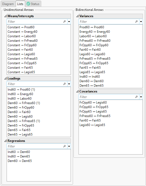

Add Covariances
12. Select FrOpp60 in the From List, select Legis60 and FrOpp65 in the To List, and click the bidirectional arrow Image shown here button.
13. Select FrOpp65 in the From List, select Legis65 in the To List, and click the bidirectional arrow Image shown here button.
14. Select FrPress60 in the From List, select FrPress65 in the To List, and click the bidirectional arrow Image shown here button.
15. Select Fair60 in the From List, select Fair65 in the To List, and click the bidirectional arrow Image shown here button.
16. Select Legis60 in the From List, select Legis65 in the To List, and click the bidirectional arrow Image shown here button.
Figure 8.7 Covariances
Covariances

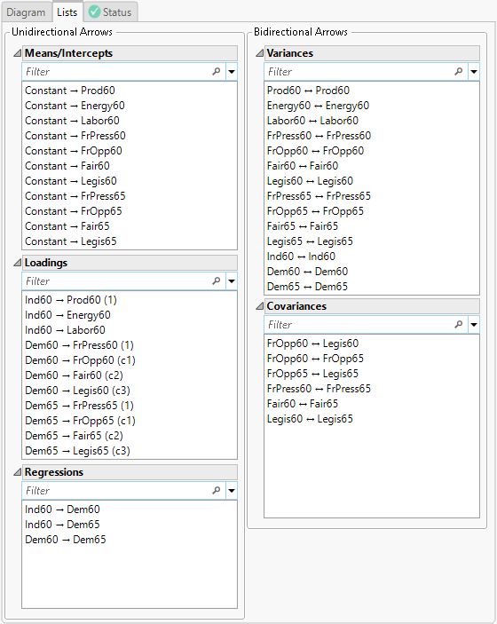

Add Constraints on Loadings
17. Select Dem60->FrOpp60 and Dem65->FrOpp65 in the Loadings list and click Set Equal.
18. Select Dem60->Fair60 and Dem65->Fair65 in the Loadings list and click Set Equal.
19. Select Dem60->Legis60 and Dem65->Legis65 in the Loadings list and click Set Equal.
Figure 8.8 Completed Model Specification
The constraints on the loadings are designated by alphanumeric labels. For example, you can see that Dem60->FrOpp60 and Dem65->FrOpp65 are set equal because they both are labeled “c1”.

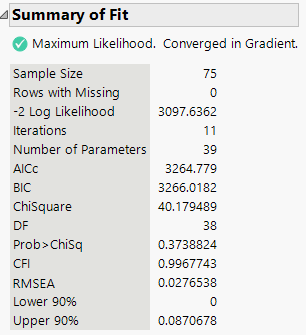

21. Click Run.

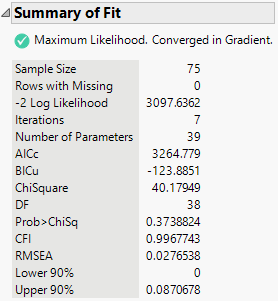

Figure 8.9 Structural Equation Model Summary of Fit Report
The chi-square statistic for this model, which is listed in the Summary of Fit report, is 40.18 with 38 degrees of freedom. Note that the corresponding p-value is 0.3739, which is not significant. This indicates that there is not evidence to reject the null hypothesis that the model fits well. Therefore, you conclude that this model fits the data reasonably well.
The chi-square value depends on the sample size, and thus, some well-fitting models can still produce a significant chi-square value. The comparative fit index (CFI) and root mean square error of approximation (RMSEA) provide additional guidance for determining model fit. These indices are bounded between 0 and 1. CFI values greater than 0.90 and RMSEA values less than 0.10 are preferred (Browne and Cudeck 1993; Hu and Bentler 1999). Here, the CFI of 0.9968 and RMSEA of 0.0277 indicate a very good fit.

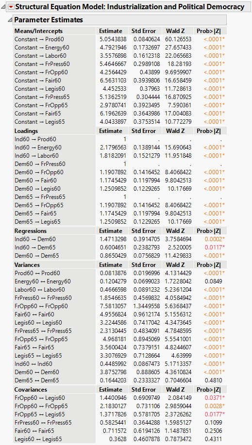

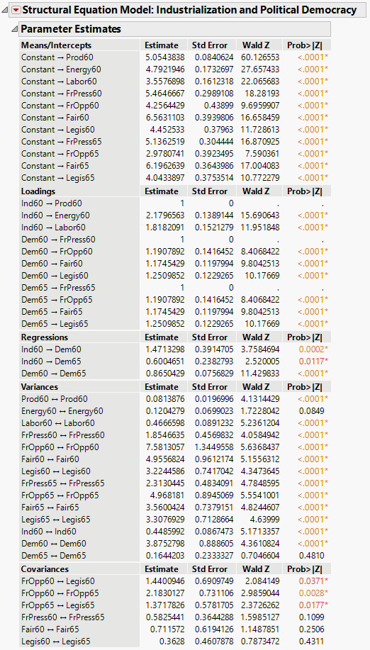

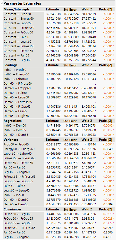

Figure 8.10 Structural Equation Model Parameter Estimates Report
Next, the parameter estimates under Regressions suggest positive effects of Ind60 on Dem60 and Dem65, as well as a positive effect of Dem60 on Dem65. Thus, higher scores on Ind60 are associated with higher Dem60 and Dem65, and higher scores in Dem60 are associated with higher scores in Dem65. The corresponding p-values for the parameter estimates are shown under Regressions. All 3 regression parameters are significant at the α = 0.05 level. Therefore, you conclude that there are nonzero relationships between the latent variables.
