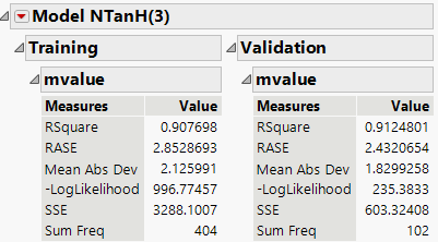

10. Click Go.
Figure 3.3 Neural Report
Neural Report
Results are provided for both the training and validation sets. Use the results of the validation set as a representation of the model’s predictive power on future observations.

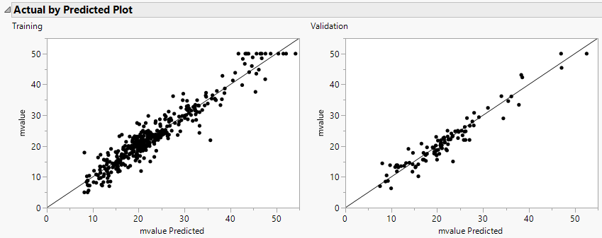

The R-Square statistic for the Validation set is 0.913, signifying that the model is predicting well on data not used to train the model. As an additional assessment of model fit, click the red triangle next to Model NTanH(3) and select Plot Actual by Predicted.
Figure 3.4 Actual by Predicted Plot
The points fall along the line, signifying that the predicted values are similar to the actual values.

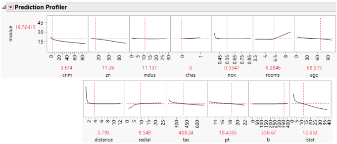

To get a general understanding of how the X variables are impacting the predicted values, click the red triangle next to Model NTanH(3) and select Profiler.
Figure 3.5 Profiler
Profiler
Some of the variables have profiles with positive slopes, and some negative. For example, the variable rooms has a positive slope. This indicates that the more rooms a home has, the higher the predicted median value. The variable pt is the pupil teacher ratio by town. This variable has a negative slope, indicating that the higher the pupil to teacher ratio, the lower the median value.
