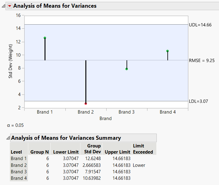

Figure 6.12 Analysis of Means for Variances Chart
Note that the standard deviation for Brand 2 exceeds the lower decision limit. Therefore, Brand 2 has significantly lower variance than the other brands.
