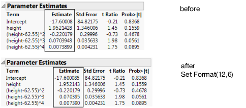

9. Change the format of the Estimate column in the 4-degree polynomial Parameter Estimates report.
pe = rbiv["Polynomial Fit Degree=4", "Parameter ?"];
ests = pe[Number Col Box( "Estimate" )];
ests << Set Format( 12, 6 );
The first argument to Set Format sets the column width by the number of characters to display. The second argument sets how many decimal places are shown in the table.
Figure 11.8 Applying Changes to a Report
Note: You can even get a single number out of the table. For example, get the estimate for the cubic term by adding the following script to the preceding script:
